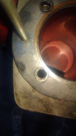

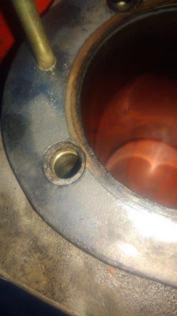

A few pictures of the gasket.
note how the enlarged holes cut into the copper rings . is this normal..?

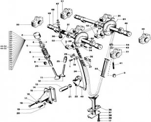

I need to purchase a new base and head gasket for this engine.. How can I be sure I get the correct ones as being in tenerife I can't just pop back to the shop to exchange them will also need items 24 & 40

Yes.
The usual sources will supply the correct gaskets.  Here in the UK Phil Todd (phil37 on this forum). Or OCT in Germany; Wolfgang Haerter in Canada since you also want  a tensioner blade and rivet (really??)

thanks but my concern is that as there are very few with the locating dowels does that need a special gasket ?
