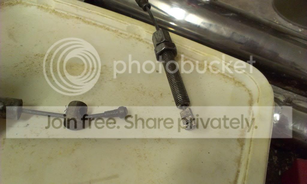

Here's a picture of the cable I've taken off, you can see the filed down home-made end

Ah........hang on a second, the nipple on the clutch end will be wrong!! It looks like something similar to the trumpet nipple on the handlebar end is what's needed but without the barrel. The filed down end I've got now looks suspiciously like a "BRASS DRUM NIPPLE 6mm x 8mm soldered"...hmmmm
I think you will find that Laverda fitted 2 different type of clip that the nipple fits into at the engine end of the cable - you most likely have the earlier style which is why you need the thinner or filed down nipple. May be best to get a later clip so the more commonly available cables fit easily.
