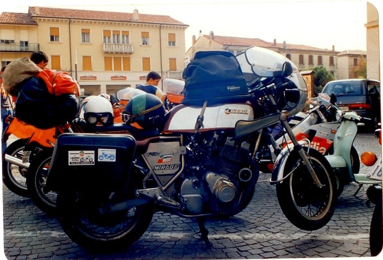

Does anyone recognize the last bike? Right, Andy Wagners 1200 Mirage... ;-)

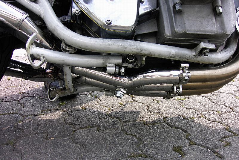

So I looked at the changes and found something I had never seen before - a 3-2 Exhaust system that virtually has no collector box. See:
The bike now ran almost perfect, the drop in power in midrange was still a bit there but way less than before and it easyly reved up to 8.000 in last gear! What a bike...

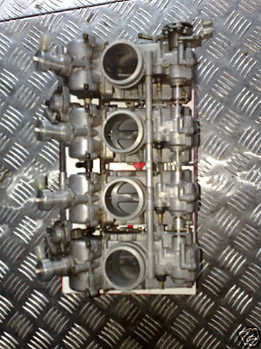

I bought me a set of Keihins out of Ebay. They were the down-draft kind of OEM Keihins, used on Suzuki and Yamaha "R"-Versions in the late 80's, beginning of 90's.
As these carbs were OEM ones, they also had choke-systems (not all have...), but the design of the choke-slider did not allow to change it to the new distances. I ended up making my own new one. laser-cut out of 1 mm stainless steel...:
The difference of the Keihins to the Dell'Ortos are so obvious and named in some secounds:
-smooth bore for better constant venturi
-this leads to easier and more precise setup
-easy access of the main-jet and air-jets for fast setup
-easy access of the needle for fast setup
-roler-setup on the slider
-slider design to minimize the negative influence on the venturi
-way more stabil in their connections (I think it is 5 fixed connections opposit to two on the Dell'Orto)
unfortunately, the carbs were "well used" and quiet dirty, and also doing the linking was not so easy for me without the right tools, so I contacte Stephen Topham, the Mikuni-Distributor for Germany (as the Keihin Distributor did not want to help me, he just wanted to sell me a new Unit for roughly 1200?...). After roughly 2 weeks, the carbs came back to me, well cleaned (ultrasonic...), new jets and needles and pre-set and pre-synced for direct usage on my bike. Mounted on the bike, you could see almost the power they deliver...:
The result were some impressive figures: 100HP at rearwheel and roughyl 101Nm. No clutch correction figures have been used to avoid the clutch push-rod to get damaged. If you add a low figure of roughly 12% to these numbers you get to 112 HP and 113Nm at clutch. I was (and am!) very much pleased with it!! ;-)

did the bike companies not engineer a dip in the powerband there deliberately as that was where the noise testing was done?
Any chance of a full on view of your collector?
I know you made a diagram, but it would be good to make a plan view from above or below.
Could you market such a device?
If it solves the dip then I am sure others would be interested in it too. (me, for one...)

yeah - that is cool about the Keihins: you feel that the engineers that developed them have worked on bikes and know what problems you have when you want to set the carbs right. Everything is really made for easy access (not only on my carbs, that is a standard feature). Also the push/pull throttle is great, as it makes sure the sliders do not 'hang' as sometimes happens on the Dell'Ortos. Motor brake is really working...
Grant,
never thought about marketing it - honestly. I did not have the exhaust off the bike since it was mounted, so - no, I do not have other shots than what I provided in the thread. At the end, the basis was a Keihan collector which was cut in two pieces: the 3 tubes just behind the area where they are linked together and the rest. everything behind the linking-area has been thrown away and simply two 32mm pipes streigt backwards (very slight angle...) have been welded in that have a 45? angled piece at the end to connect them to the Jota pipes. For a welder that is able to do stainless welding, this should not be any problem to copy I think.

  Keihin carbs fitted some to Monty earlier this year,can only agree with your comments;except the mixture skrew,you'd laugh could I find it,not till I got a mirror and poistioned it under the float bowels!Strange turning something you can not see.
  I suppose you'd be better off calling your collector box a junction box.By the way does it have any sort of metal bridge(between the pipes) to support them at the opposite end to the juction box?
