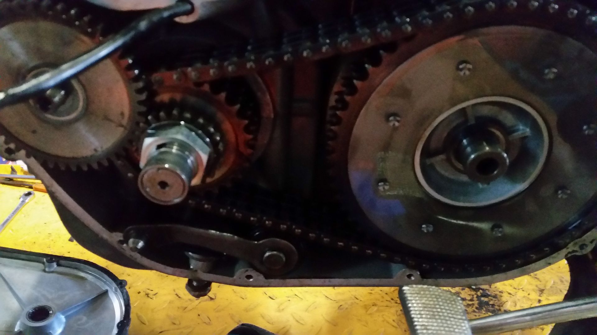

Ok, so off with primary cover, undo crank nut and hit first snag.
Couldn’t get the oil pump gear off for love or money. Ask some more questions and just gently keep trying (noting advice not to lever the gear!!) Eventually I felt some movement and confident the key was in the right spot applied a bit more force and out she came. One of the problems was that the shaft was tight and did not turn freely in its bore – more on that later. My key way was at 3 o’clock.
So off with the sprocket, primary chain and clutch drum.

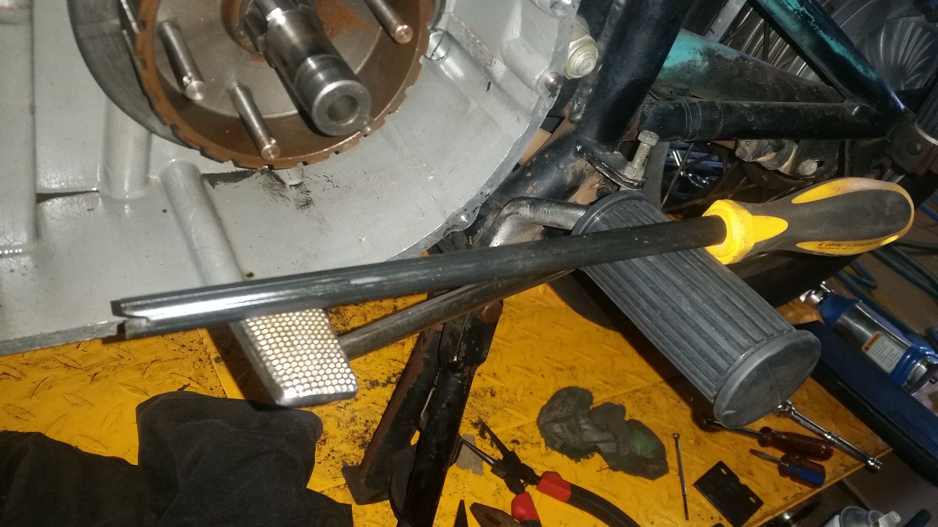

Had a good look at the pegs securing the clutch and decided they shouldn’t be too hard to get out but obviously needed a slotted tool to push while removing the pegs.
So whipped around to my tool bench and manufactured an appropriate tool!!
Actually that is a bit of hard plastic tube I found on my garage floor from an unknown source which had the perfect inside and outside diameter. I just cut a slot and shoved a screw driver down the other end as a push handle ;)
Removing the pegs turned out to be quite easy. As you compress the buckets just turn the rods so pegs are vertical and once buckets pressed far enough in they just drop out, so pretty much a one handed job while holding the bike stable.

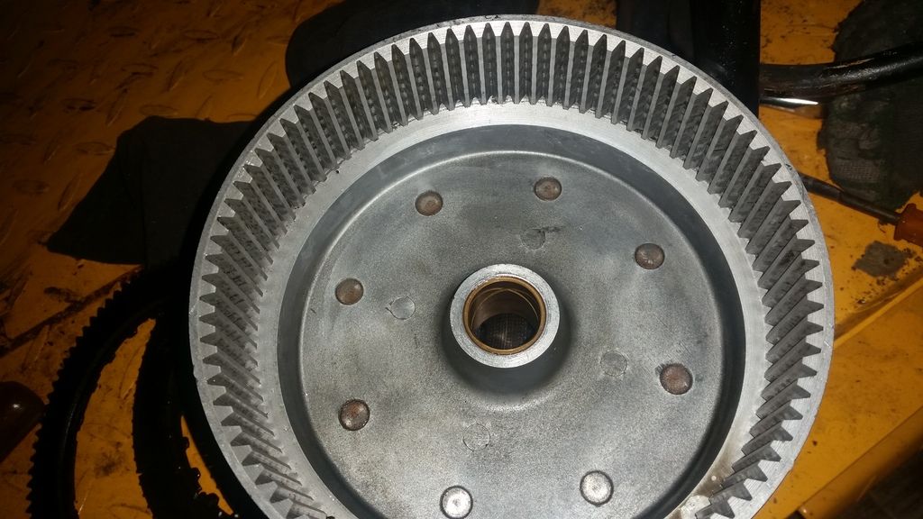

With clutch apart also thought it best to replace the clutch cush rubbers so this obviously necessitated removing the rivets (subject has been well covered before). Rivet rivet...:-
Read on here that it best to drill the rivets to avoid damage, however as I did not have a drill press decided to cut them off using (Pros, look away now :o) – the dreaded Dremel. Actually this worked brilliantly as I could cut close to the surface and with a very gentle tap the rivets just fell out. (obviously using the proper reinforced Dremel cutting wheels available and not the standard ones which shatter at the mention of any hard work.)
With all apart, took the clutch drum to my local engineering works (who I know are particular) and had them drill and tap for replacement screws. Put in new clutch rubbers and assembled using hex heads as recommended.
All done, new clutch plates to hand and time to reassemble. Clutch drum looked fine:-

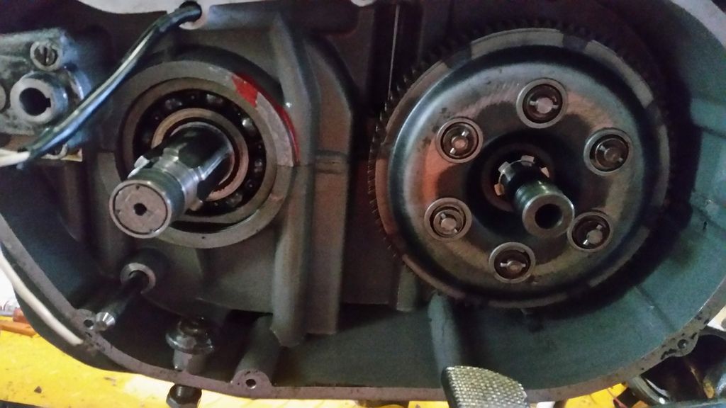

Ahhh, first question, how to hold everything while you compress the "buckets" against the clutch springs to enable placement of pegs with motor in situ?
Enlisted one of my adult sons for help, however this resulted in much arguments about who was not doing their bit right, bike nearly toppling over a couple of times, no pegs inserted and as it was Friday night, tools down and tinnies up (drink)
Next morning decided to tackle by myself with a clear head and new thought process.
Process was – Sat on a low stool with chest directly in front of the clutch (bike was on a lowered bike ramp)
Held top frame rail with left hand, positioned push tool slotted end in each "bucket" with other end pressed against chest (suitably padded with rags) Pushed on tool with chest to compress the clutch springs and used right hand to place pegs in hole with needle nose pliers, often just starting them off then easy to tap them home. After a couple of goes, Eureka, in they went and smooth sailing using this process for the remainder of the pegs. Easy as!!
(Obviously another solution would have been to very securely tie bike down, but c’mon no easy options here and I think it felt more secure holding against own weight!)
Reassembled the primary drive and tried inserting the oil pump gear however the shaft was definitely binding.
Had previously cleaned up the bore in the pump with a bit of wet and dry and ensured it turned freely however something was definitely amiss as when inserted it was not free to turn. Took apart and loosened pump. Inserted and all good. The pump was definitely going out of alignment when tightened. Decided a shaft needed to be inserted prior to tightening so used a 12mm (I think it was) axle I had to insert giving me room while starting to tighten. I also replace the slotted screws with some cap heads so I could then take out axle shaft insert the gear shaft most of the way and still able to tighten further. I know the manual says to partly install gear to ensure alignment but this really needed to be in until nearly fully tight or the pump would somehow misalign. This worked well and gear could now be inserted freely and rotate easily. Amazing, another win!
Reassembled primary cover, installed the advance mechanism and points, put in fresh oil and took for a test spin. Glad to say, no slippage and effort well worth it……………..
