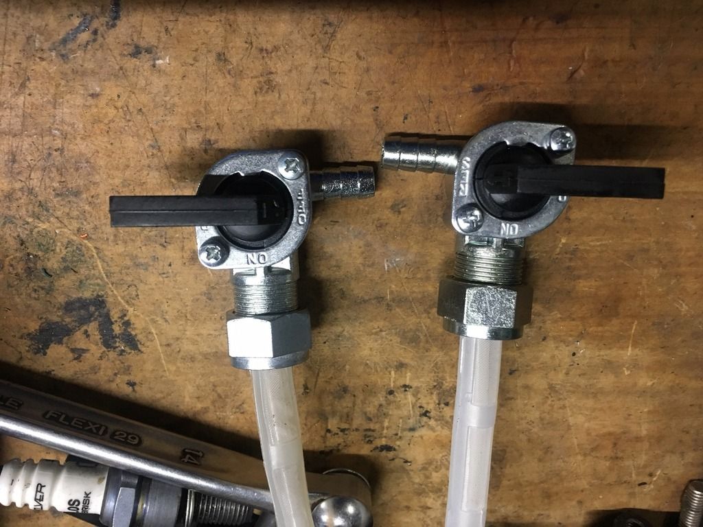

As am having issues with the BAP taps esp on the FCR carbed bikes ( FCR's have smaller float bowls so need more flow out of the taps ) looked around for a decent replacement.
Got a set of the Paioli copies made by OMG but when they arrived found that they are real nicely made and give great flow however the down side was off on the left tap was lever back instead of forward like the right hand tap.
Now I am a lever forward is off type guy,  as all my bikes are this way, so I dont want to be thinking which way a tap is for off.. Conrods are too damn expensive to have to worry about shit like that.
So as I had a good few hours to think over the weekend decided instead of complaining as the taps apart from that are well made and have good flow decided to solve the problem.

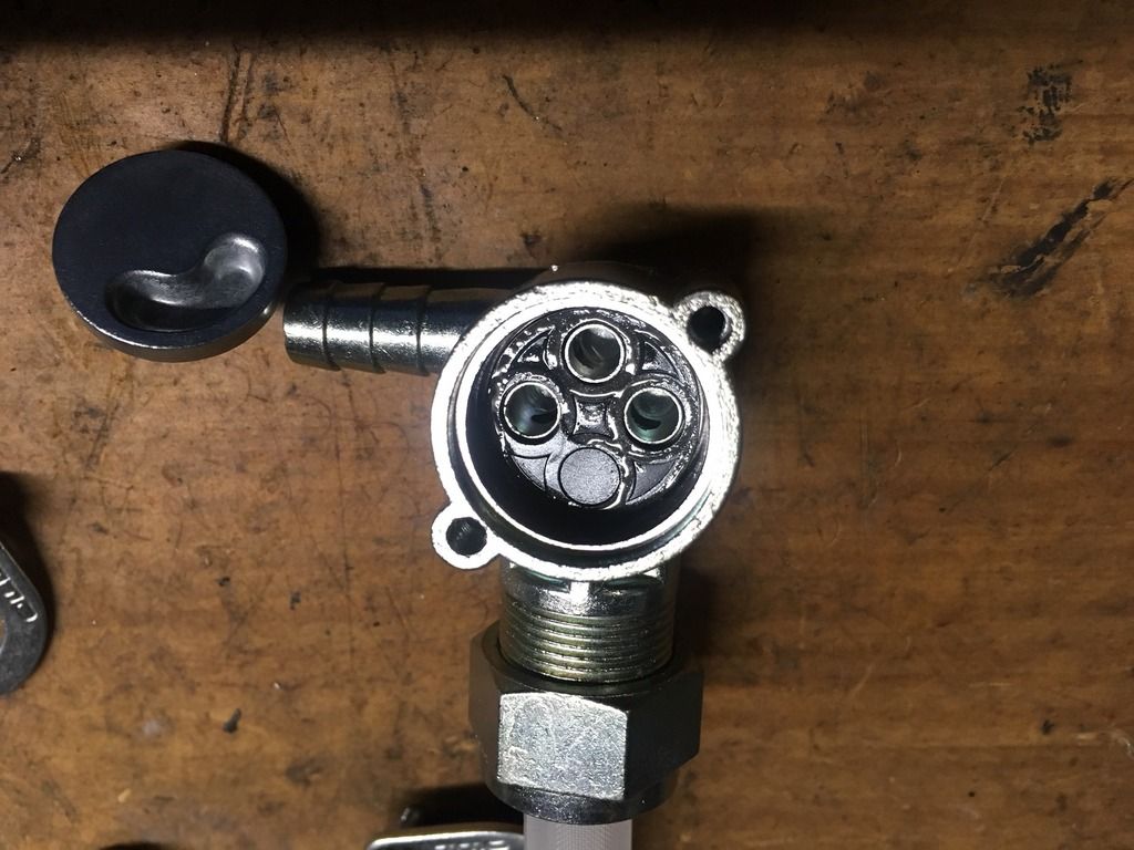

As soon as I pulled the taps apart found the problem, they only make one type of shut off valve so hence why off is one way one side and the other way the others side. If I simply reversed it then off would be forward but on would have to be up instead of down so thought about it on Monday and presto the solution was easy as 1,2,3.  Just have to mirror the cut on the valve on the other side of it and should work.

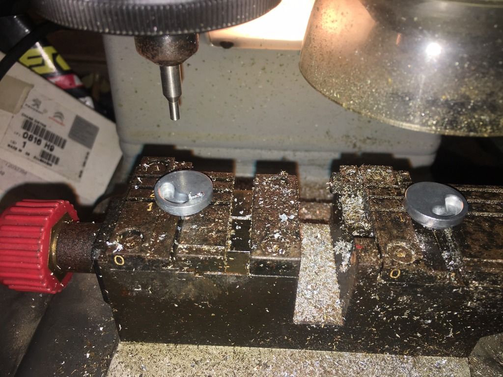

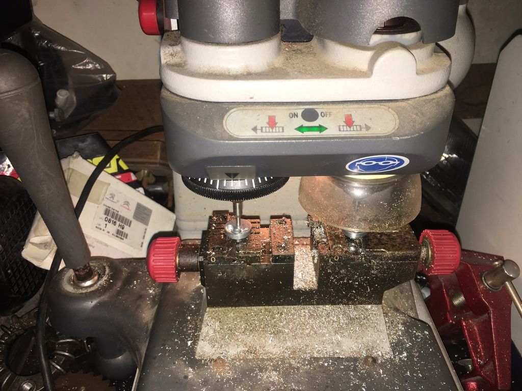

Was going to use the mill and measure and slowly work but as I had a Silca Matrix sitting there ( used for cutting lazer keys ) thought would put it to use.

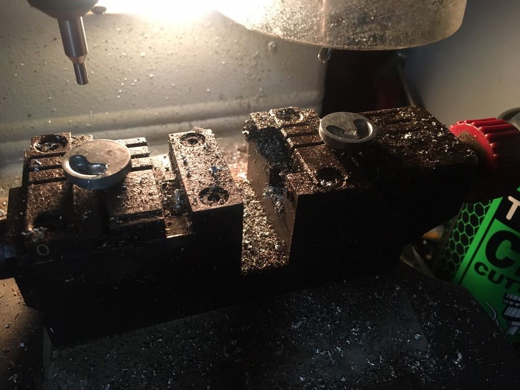

First thing was to custom made a jaw to hold the valve to be cut in the correct position then mounted up the guide valve on the trace side and the valve to be recut on the cutting side, use the set up lights to ensure both were spot on in position and then was a simple matter of mirroring the other side with the right size cutting tip and then refitting.

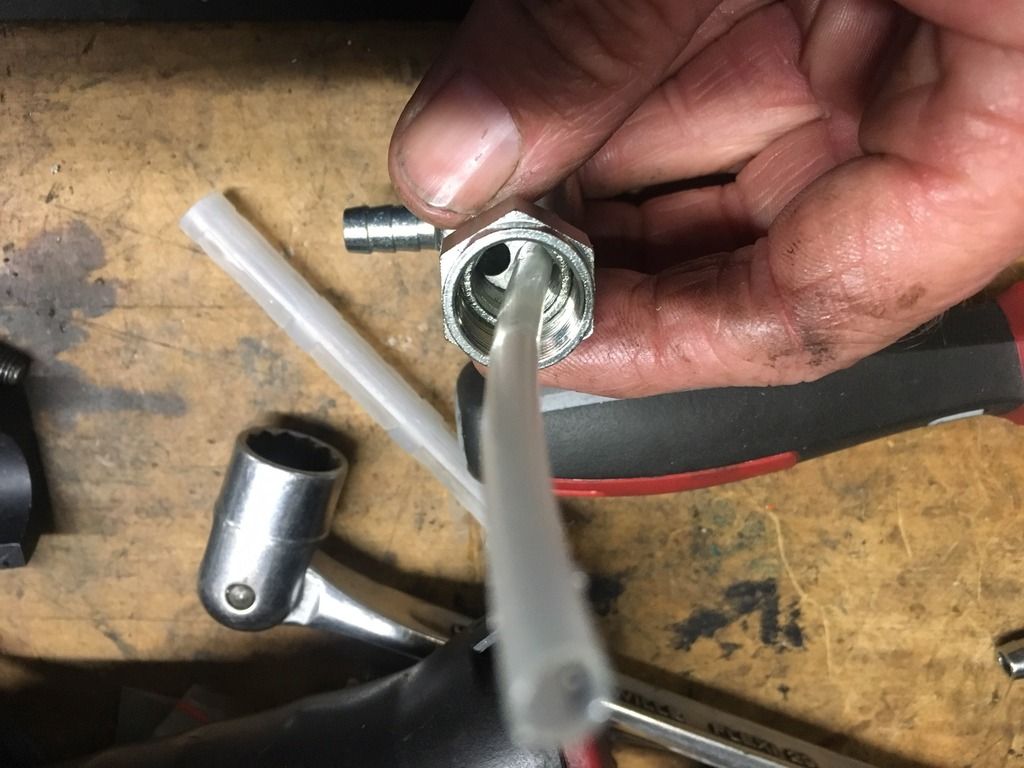

Had to swap the hose as now the on and reserve feeds were different locations and all working so as had bought two sets, did the other left hand tap also. Now have two set of taps which both turn off with lever forward, so  only job left is to change the wording on the plates to reflect the new positions... have a plan for that might not be as pretty but will serve the purpose. Then it will be job done, fit to bike and move on to next project.
New taps off is in two different directions.
Inside the tap and how the valve works
Setting second one up in the Matrix
Setting up valve to be cut spot on.
Valve after cutting
Cut valve ready to be refitted
Hose swapped over
Job done.. both taps now off lever forward.
