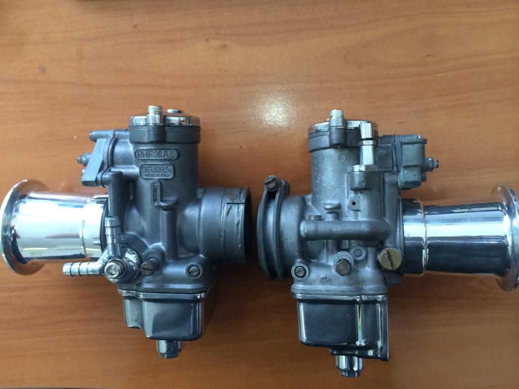

Red finished the motor and I started the process of building up the bike. Lots of time has been spent considering lots of options.
This isn't intended as an SFC replica, far from it. It just has a few SFC style parts. Boba is doing the SFC style carbon bodywork now.
The motor should go pretty good, here's a list of what Red did.
Bore 880cc Piston/Liner/Gasket set for 750 twin, ex Andy Wagner
92mm liners
Oil Cooler provision, Nipple adaptors
Bore and hone barrelsMachine top of barrels
Machine 8 x Engine studs, wasted to 8mm
Bored and Honed barrels
Machined primary drive sprockets, crankshaft and clutch to 2 row teeth
Carrillo Conrods
New Big End Bearings & cages
SFC Crank middle section, 35mm big pin
Rebuilt crankshaft, pressed together at 270 deg
New Oil Slingers
New Big End pins
Carbon Fibre Clutch plates
Drilled oilways in Clutch Basket
SFC type clutch springs
Gearbox rebuilt
Set new dual SFC Valve Springs 4
Custom Valve Collet retainers to suit 7mm Valve stems, CNC machined
Hardened custom Valve Collet retainers
7mm Valve collets
Set SFC Rocker Arms
SFC Rocker arm adjuster screws
Custom 7mm Manganese Bronze Valve Guides
44mm Inlet Valves, coated Stainless, hardened tips
35.5mm Exhaust Valves, coated Stainless, hardened tips
Ignitech electronic ignition and a shitload of machining too.
Then I'll top it off with these Dellorto PHF36A carbs.
 And the SFC 2 into 1.
« Last Edit: June 26, 2015, 01:06 by chrisk »
